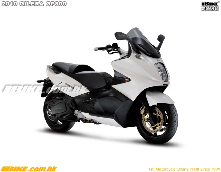

世上最強最快的綿羊Gilera GP800,在2010有改良項目令產品更細緻動人。839cc V2 SOHC每汽缸4氣閥雙點火引擎,車架採用中置式引擎設計,引擎和尾搖臂分家,不會依隨著尾搖臂動作上下擺動,令重心前移,帶出真正電單車的操控感覺。相比起Silverwing和AN650的GT巡航路線,GP800的外型走T-MAX式的運動型路線。單騎車身傾斜角度可達45度,極速約200km/h,0-100km/h加速只需5.7秒。別忘記這是世界上唯一採用鏈傳動的終極綿羊。綿羊dream bike莫過於此。

Everything about the Gilera GP 800 has been designed, developed and made to rule the road. Each individual stylistic choice and technical solution speaks of a revolutionary machine, conceived around the first ever 90° V twin scooter engine, and designed to dominate the world of scooters. The 839.3 cc engine features liquid cooling, Magneti Marelli electronic fuel injection, a single cam, 4 valves per cylinder and twin spark ignition. It develops a mighty 75 bhp at the crank with a torque of 73 Nm, 95% of which is already available at 3,500 rpm. These specifications are totally unique in the scooter world. On the road they translate into an extraordinary reserve of constantly available power and a uniquely smooth ride. Thanks to CVT (continuously variable transmission) with engine braking effect, urban commuting is effortless and relaxing, with the ideal ratio automatically selected. But when the road leaves the town and opens up, the GP 800’s V twin engine really comes into its own, placing Gilera’s flagship scooter in a class of its own.
The Gilera GP 800 engine features dry sump lubrication, and is secured rigidly to the frame by vibration-damping rubber mountings. Final drive can therefore be entrusted to a robust but sophisticated, Regina Z-ring sealed chain.
The exhaust system is totally decoupled from the frame to minimise vibrations. This 2-in-1 system terminates in an aggressively styled silencer with a black heat shield that adds plenty of character to the styling of the GP 800, and emphasises its elegant but sporting nature.
The amazing performance of the GP 800’s V twin engine have been achieved in full respect of the environment. Emissions have been minimised by an advanced closed loop injection system with Lambda oxygen sensor and an exhaust with three-way catalytic converter. Fully integrated control of the electronic ignition system also ensures that the GP 800 conforms to strict Euro 3 standards.
The twin cylinder power plant has been designed, developed and manufactured entirely in Pontedera, the historical home of Piaggio and one of the world’s most advanced engine development and production centres. This engine is born from the challenge that the Piaggio Group has taken on: to offer an ever more sophisticated customer a product that guarantees performance, reliability and safety while also leading the field in respect for the environment.
A TRULY IMPRESSIVE CHASSIS
The Gilera GP 800’s double cradle frame has been designed around the engine to embrace it and convert its exuberant power into rigorous, precision control. The frame is made from a tubular steel trellis with steel reinforcement and strengthening plates.
Excellent torsional and flexural rigidity has been built in at all stages of the development and road testing process, to deliver an amazing sense of control. The Gilera GP 800 corners like a sports motorcycle, reaching angles of lean of 45° while still delivering neutral handling and amazing road holding.
  The GP 800 holds the most precise lines through fast bends, obeying rider input at all times without ever exceeding performance limits. Absolute control is the result.
With its new steering angle greater than the previous version, the GP800 acquires manoeuvrability when starting off and in city riding. The generous power of the GP 800’s
engine demands a superbly rigid chassis. Simulations and road tests have demonstrated that the GP 800 has a coefficient of stability at full power similar to a motorcycle and almost twice as high as a conventional scooter.
What truly stands out in the stationary view of the GP 800 are the new flexible coupling and the powerful swingarm now painted black to embellish the vehicle and accentuate its lines. This impressive component symbolises how the Piaggio Group has drawn on its experience in motorcycle design in developing the amazing GP 800. The swingarm is in cast aluminium and is secured directly to the
side plates of the frame. It is damped by suspension linkages that are dominated by a horizontally mounted, lateral hydraulic monoshock absorber, adjustable to seven different preload settings. Reduced unsuspended mass and a generous 133 mm of rear wheel travel ensure excellent suspension performance.
The front wheel fork, also in aluminium, is now black and has 41 mm stanchions. Once again, stability and safety, even under harsh braking, are at a level never previously found on any scooter.
The hollow five spoke wheels, 16” at the front and 15” at the rear, are manufactured from aluminium alloy in a lost core, gravity casting process to minimise unsuspended mass and guarantee motorcycle-type precision handling. Overall performance is also helped by standard equipment radial tyres, 120/70 at the front and 160/60 at the rear.
The braking system is fitted in the front with Brembo Gold Series double piston floating callipers and two 300 mm semi-floating steel discs, now gold in colour. In the rear, the double opposed piston floating calliper interacts with a 280 mm steel disc, also in the new shade of gold. The brake pipes are covered with metal plait. The adjustable 4-position levers and new brake pumps are further proof of the attention paid in designing the braking system.  The GP 800 is even equipped with a parking brake operated by a practical lever on the right of the leg shield.

Engine
90° longitudinal V-twin, 4 stroke.
Engine capacity
839.3 cc.
Bore
88 mm.
Stroke
69 mm.
Compression ratio
10.5 : 1.
Max power at driveshaft
75 hp (55.16 kW) at 7,750 rpm
Max torque
73 Nm at 5,750 rpm
Exhaust
Closed loop system with Lambda probe and three-way catalytic converter.
Timing system
SOHC (single overhead camshaft), 4 valves, electronic fuel injection.
Ignition
Electronic inductive discharge ignition, variable timing. Electronic control unit with engine immobiliser and warning LED. Automatic fuel shutoff in case of tip-over. Twin spark ignition.
Starter
Electric.
Cooling
Liquid with three-way thermostat.
Gears
Belt primary drive. CVT (continuously variable transmission) with engine braking effect. Chain final drive.
Clutch
Centrifugal clutch.
Frame
Double cradle, high strength tubular steel trellis.
Front suspension
41 mm aluminium alloy telescopic hydraulic fork; 122 mm wheel travel.
Rear suspension
Aluminium alloy swingarm with laterally mounted, horizontal, hydraulic monoshock. Seven-position spring preload adjustment. 130 mm vertical wheel travel
Front brake
Double, 300 mm semi-floating stainless steel discs with two Brembo double piston floating callipers.
Rear brake
280 mm stainless steel disc; floating calliper with two opposing pistons.
Front wheel rim
Die-cast aluminium alloy, 3.50x16”.
Rear wheel rim
Die-cast aluminium alloy, 4.50x15”.
Front tyre
Tubeless radial, 120/70  R 16”.
Rear tyre
Tubeless radial, 160/60  R 15”.
Length
2,230 mm
Width
800 mm.
Wheelbase
1,585 mm
Seat height
780 mm
Fuel tank capacity
18.5 litres (including 3 litre reserve).
Max speed
Approx. 200 km/h
Emissions
Euro 3
Max angle of lean (rider only)
45°
   (0 – 100 km/h)
5.7 sec
