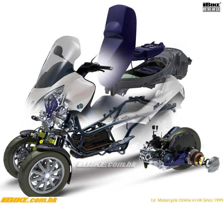

MP3 Hybrid結合125cc內燃機和Lithium ion鋰電推動一台約3kW直驅式馬達。MP3與一般混能車不同之處乃主要動力來源是內燃機與馬達合併輸出動力(Parallel hybrid drive),總功率可達14kW(19PS) 可媲美一般150cc-200cc機車之輸出。
內燃機除了主要負責行車之外,也會替電池進行充電。新車共有四種行車模式,分別是:

The Piaggio MP3 Hybrid incorporates a “parallel” hybrid drive in which a combustion engine and an electric motor are mechanically and electronically linked and simultaneously supply power to the wheel in perfect synergy.  In this integrated internal combustion/electric powertrain, the internal combustion engine - the petrol engine - works like a normal catalysed four stroke unit, offering excellent performance.
Whenever the rider calls for particularly brisk acceleration, the electric motor kicks in, supplementing the petrol unit to provide up to an 85% boost in performance, offering more immediate and responsive pickup during the first few metres - which is precisely where it is most needed in city use.
Through the “Ride by Wire” power control system, the on board electronics (VMS – Vehicle Management System) decides how much power to draw from the petrol engine and the electric motor in relation to the effective operating conditions to optimise both performance and consumption.

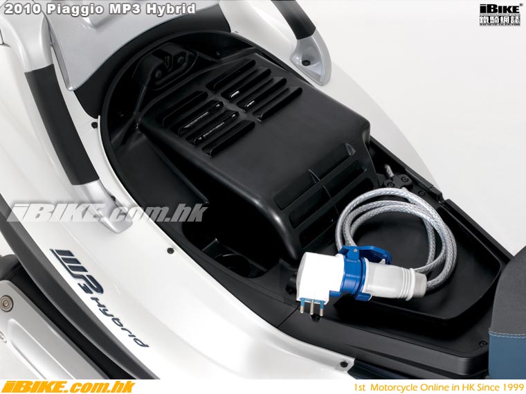

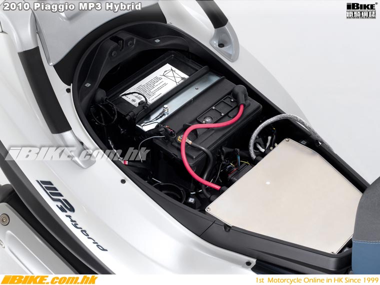

The battery pack, with integrated control electronics, is hidden away in the compartment under the saddle, which still has enough room to accommodate a helmet and other objects.
An indicator integrated into the dashboard lets the rider keep a constant eye on the battery charge level. The vehicle is charged easily from the mains with a normal electrical cable, plugged into the relative socket with the panel switched off.
The full charge cycle takes approximately three hours , although 85% charge is achieved in just two hours.
