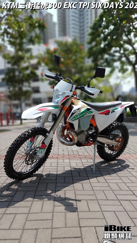

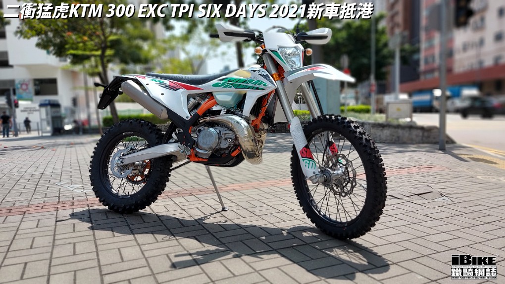

KTM 300 EXC TPI SIX DAYS以橙色車架為記,這個液壓成型的鉻鋼框架是以最先進的機器人焊接而成。車架經過實戰驗證,為車手提供最出色的反饋、操縱性和穩定性。

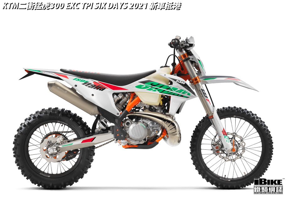

6 Days Editon版有以下配置:
Silencers with new SIX DAYS logo
Rims with new SIX DAYS logo
Engine guard
Front axle puller

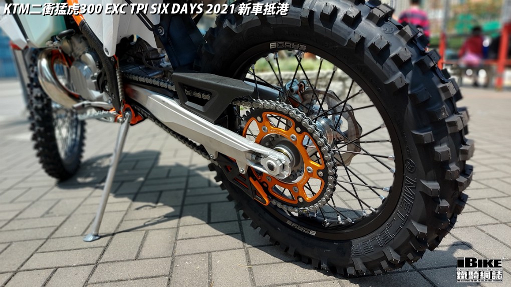

Stealth rear sprocket
Handlebar with new SIX DAYS logo
Solid rear brake disc
Floating front brake disc
Orange frame
Orange CNC triple clamps
Orange chain guide

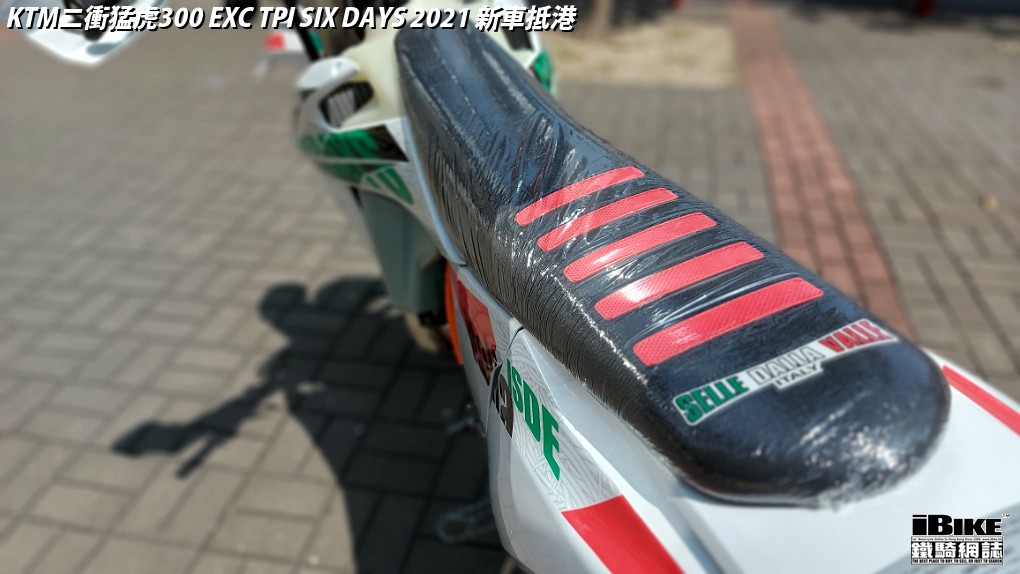

SIX DAYS seat
SIX days graphics

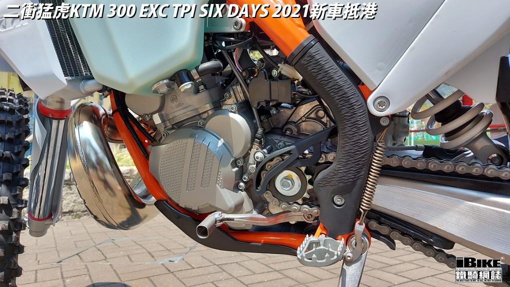

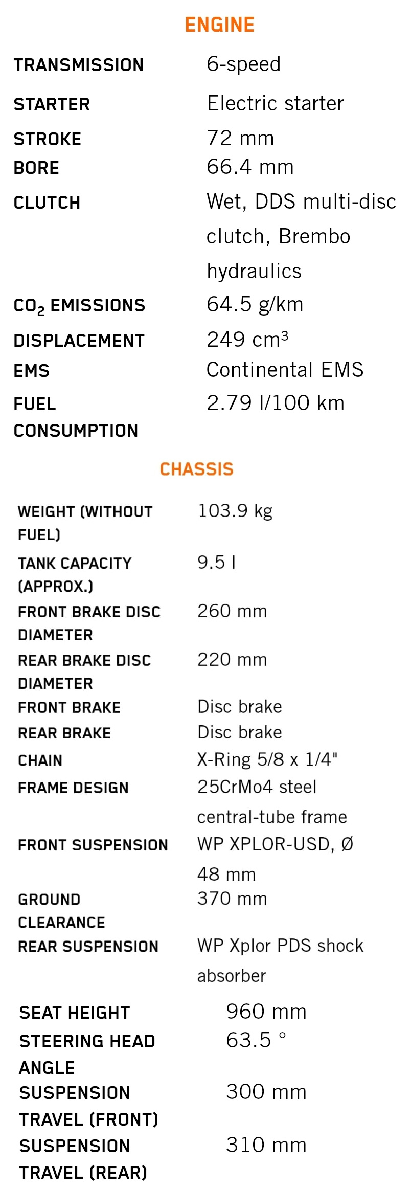

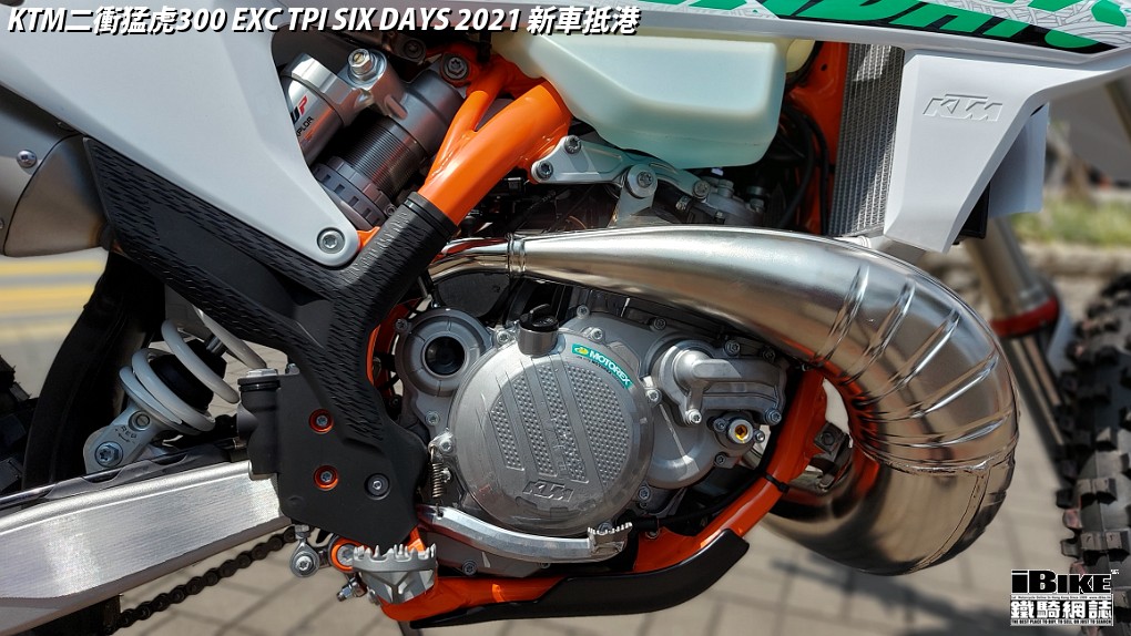

ENGINE
293.2cc 2 stroke motor
Cylinder bore of 78mm
Refined port timings and a sophisticated power valve
39mm throttle body by Dell’Orto
Small tube in back of cylinder supplies air pressure data
Cylinder allows for a more traditional type of spark plug
Die-cast engine cases for strength and durability
Engine case surfaces designed to reduce wear by the rider’s boot

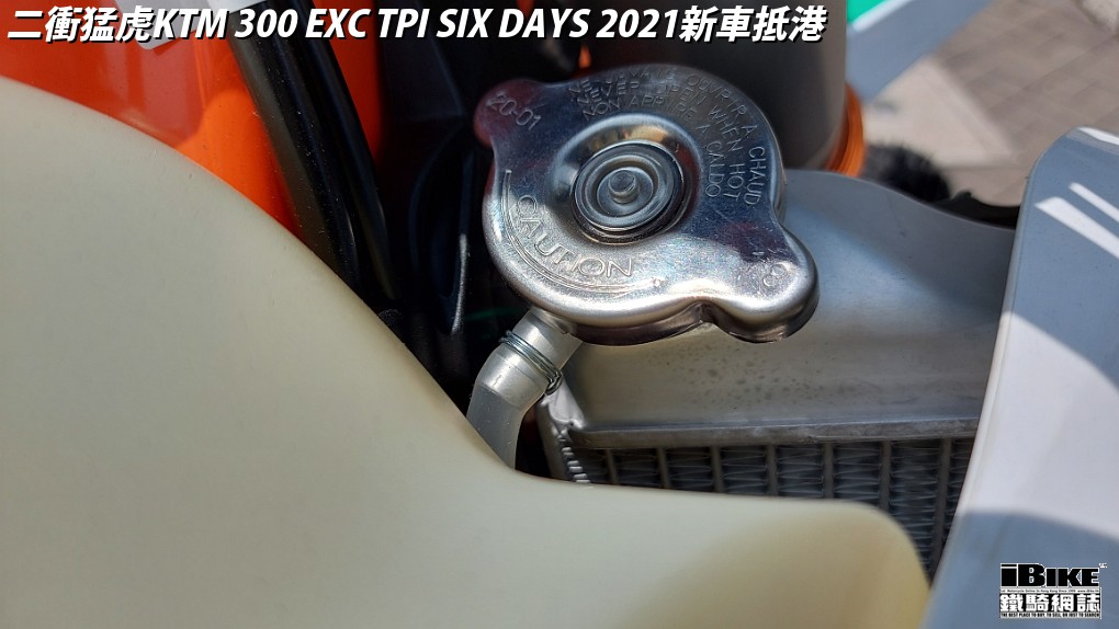

CFD circulated ventilation within radiators for efficient cooling
Radiator protectors to prevent stones and improve heat dissipation
Radiators are 12mm lower vs 2019 for optimum cooling and bodywork design
有助精確攻彎

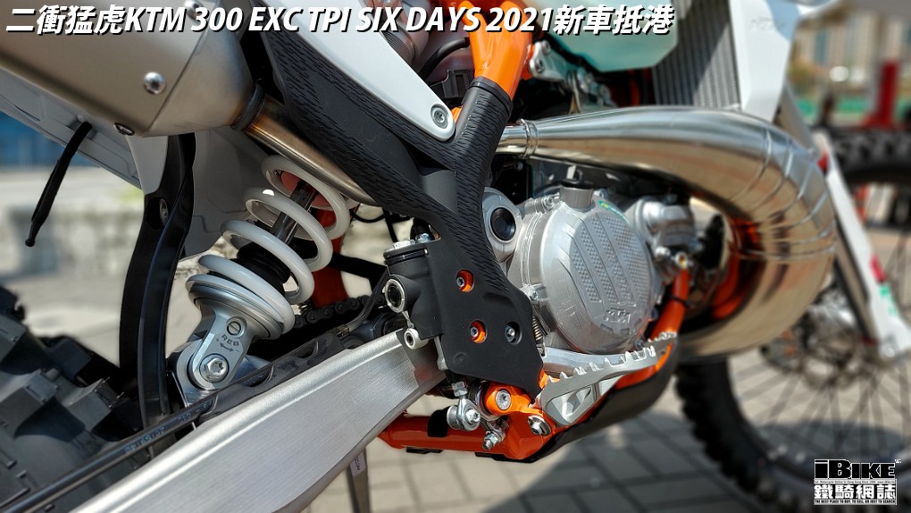

橫向安裝的引擎汽缸蓋撐條(氣缸,缸蓋和車架之間的連接)是由鋁合金製作,可以減少振動並有助精確攻彎。車身還有側面框架護板,可以改善尾輪抓地力,同時為右尾鼓提供隔熱保護。副車架由超輕及穩定的鋁材製成,重量小於900克,為後擋泥提供穩定性。
減少燃油消耗
KTM 300 EXC TPI 配備了新開發的TPI燃油噴射系統,是運動型的二衝程賽車。它們具有獨特的功能,並擁有專利的EFI系統,將兩個注射器連接到氣缸的傳輸端口,使發動機更平穩地運作,大大減少燃油消耗。
TPI燃油噴射
TPI燃油噴射系統消除了預混燃料的需要,或需要在不同環境和天氣之下改變化油器的setting,令所有越野車手都可專心駕駛,不再需要分神調較化油器的設定。
AIR, FUEL AND EXHAUST

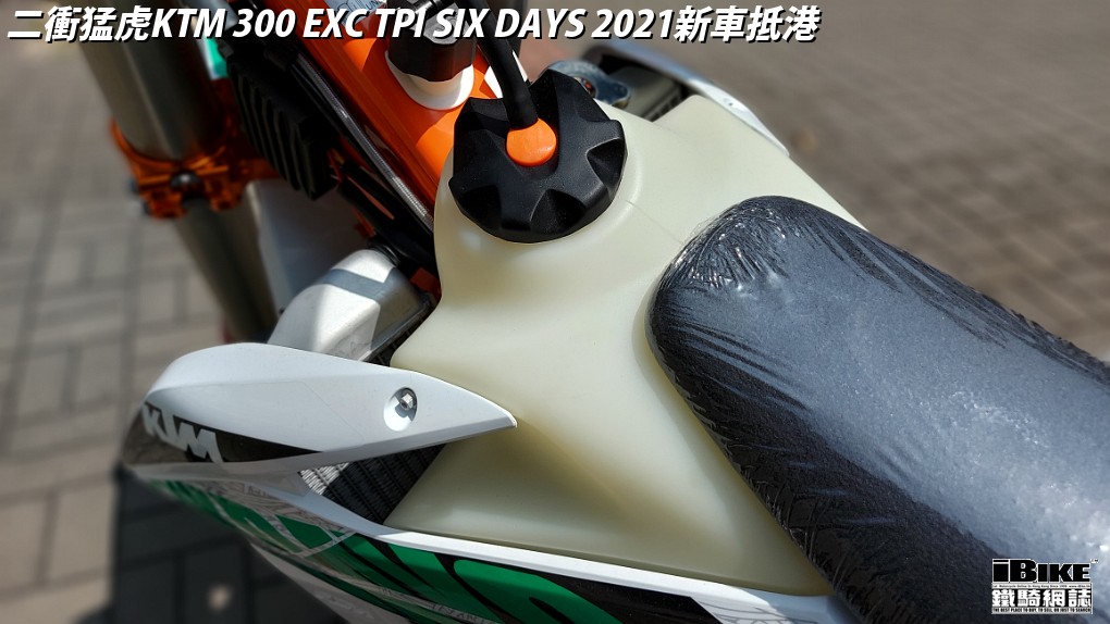

9 litre fuel tank capacity
See-through polyethylene fuel tank to check on your remaining fuel level
Quick refuelling by pushing the quarter turn orange bayonet mechanism
Integrated fuel pump and level sensor
No premixing required, oil tank for injecting precise quantities based on ECU readings
700mm oil tank provides lubrication for approximately 5 tanks of fuel
Oil and fuel mix is 80:1
Mesh filter to prevent dirt in to the oil pump
EFI application features two lateral domes, holding fuel injectors to rear transfer port
Downstream injection guarantees excellent atomisation of fuel with upstream air
Engine lowered by 1 degree around the swingarm, improving front wheel traction

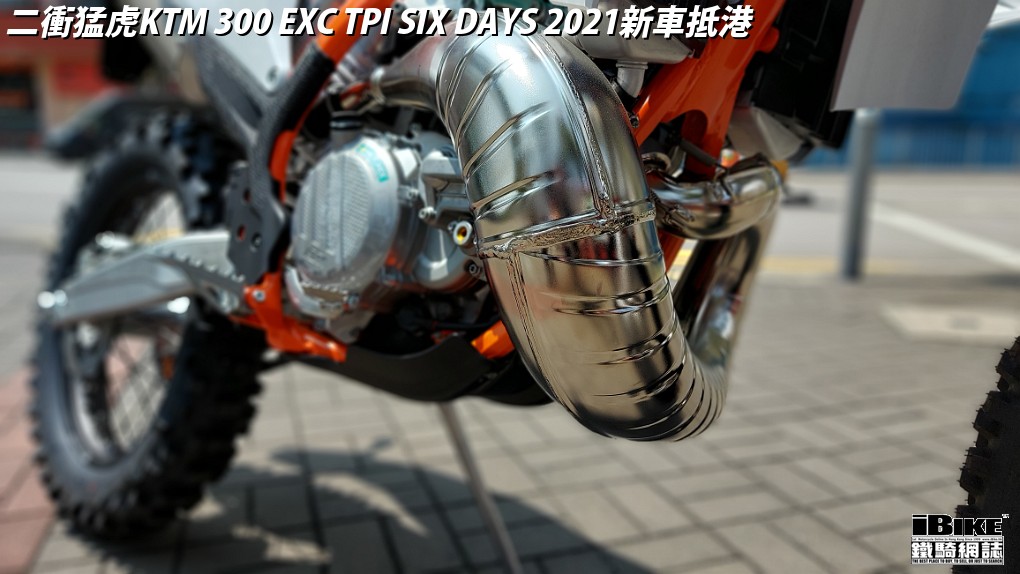

Heavy duty exhaust with ripped surface finish for superior finish and resistance to damage
Pipe produced with 3D stamping technology
Silencer reworked with new perforated inner tube and lighter wool
Plastic mounting now replaced with aluminium welded brackets, 200g lighter too
Air box prevents soiling, maximum air flow whilst remaining quiet.
Air filter mounted in a stiff cage which holds it in place.
Tool free replacement, Twin Air filter brand.
有助微細操控
由於TPI的反應比化油器更細緻,所以更容易捉摸。駕駛者作出油門調控時,更有助微細操控。另外2T混合油事由電腦控制混合,所以見唔到好乞人憎的白煙霧。非常方便及環保,唔會好似舊款咁要另外帶2T混合油出街,次次入油都要做一次人手溝油的動作。
瞬間爆發力大
KTM的TPI技術可以保留二衝機器在越野等場地車型中的好處,發揮實力的空間更大,因為場地車需要重量輕,瞬間爆發力大。同時改善傳統二衝程引擎的缺陷,和符合現代的環保廢排法規。
高質串聯設備
除了全新供油技術,KTM還配備了高品質的串聯設備,如標準電子起動器,超輕型鋰離子電池,Bremo制動系統,液壓離合器和高品質WP避震系統等等。
TRANSMISSION AND FINAL DRIVE
6 speed transmission now made by PANKL RACING SYSTEMS
Screw and diaphragm instead of circlip on secondary drive
Diaphragm Steel Clutch (DDS)
One piece clutch basket, primary gear made of high strength billet steel
Clutch is compact and reduces engine width by 10mm
Brembo hydraulics for the clutch system

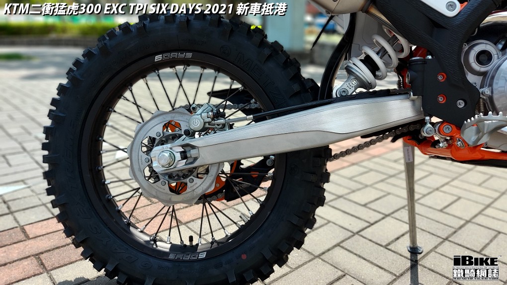

Cast aluminium swingarm for optimised position of PDS shock absorber
BODYWORK
Chrome moly steel frame
Extra light subframe made of aluminium weighing just 900g and 40mm longer vs 2019
‘No Dirt’ gear lever prevents dirt from blocking the lever
Handlebar by NEKEN with aluminium body
ODI lock-on grips, volcanised for throttle lock on for left side

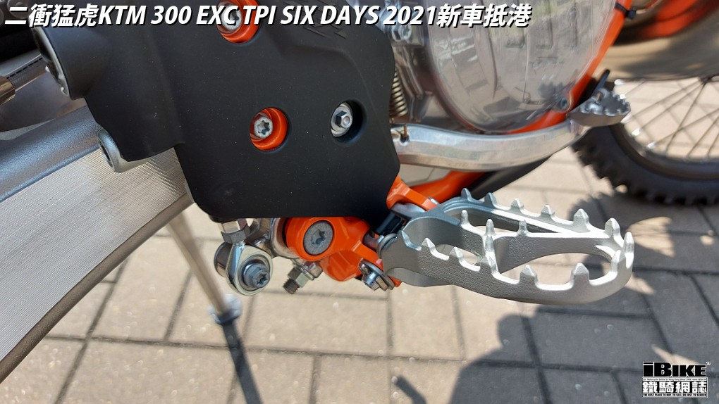

‘No Dirt’ footpegs
370mm ground clearance
960mm seat height
103.4kg dry weight
SUSPENSION AND STEERING

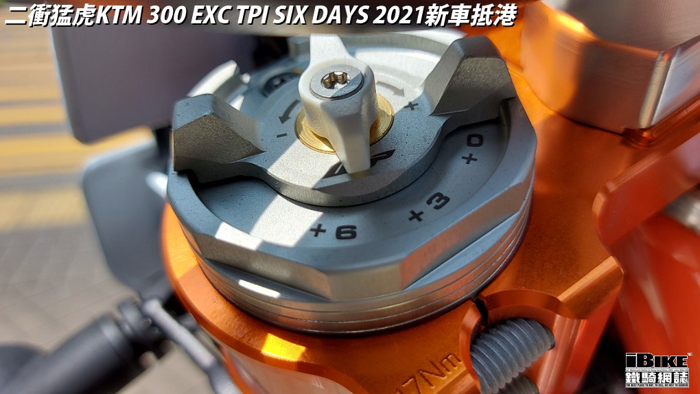

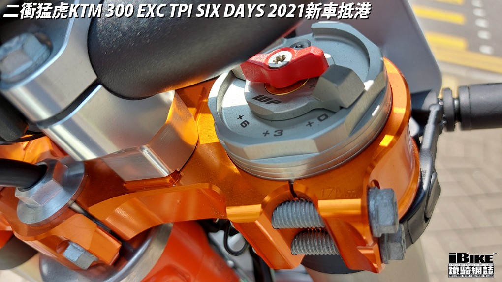

WP XPLOR USD forks, 48mm diameter, split fork design
Springs on both sides but split functions
Left is compression damping, rebound on the right
Upper fork caps and clicker adjusters
Front end higher vs 2019, less chance of bottoming out

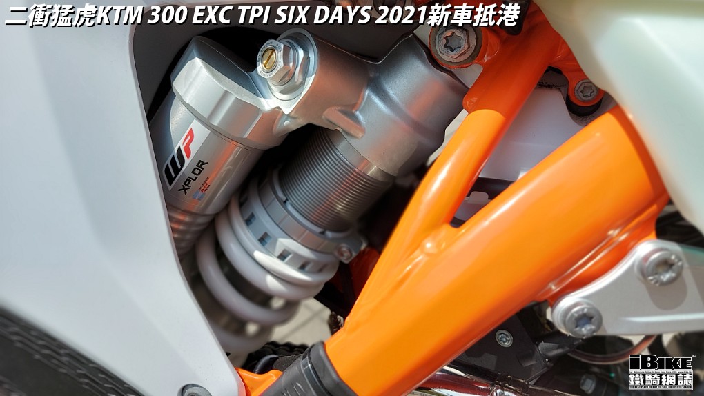

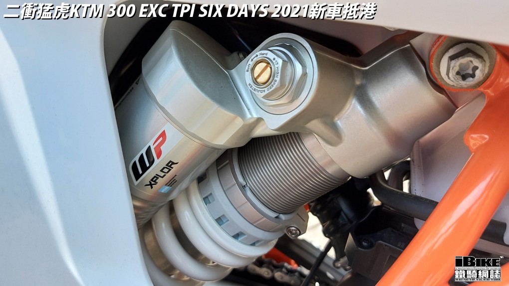

WP XPLOR PDS (Progressive Dampening System) shock absorber
PDS is a trademark of KTM where the shock fits directly to the upper side of the swingarm
300mm front suspension travel
310mm rear suspension travel
BRAKING
Brembo twin piston floating front brake calipers and hydraulics with Wave discs
Brembo single piston floating rear brake caliper and hydraulics with Wave discs
Steel flex front brake hose with protection with speedo cable channel
260mm front disc brake diameter
220mm rear disc brake diameter
WHEELS

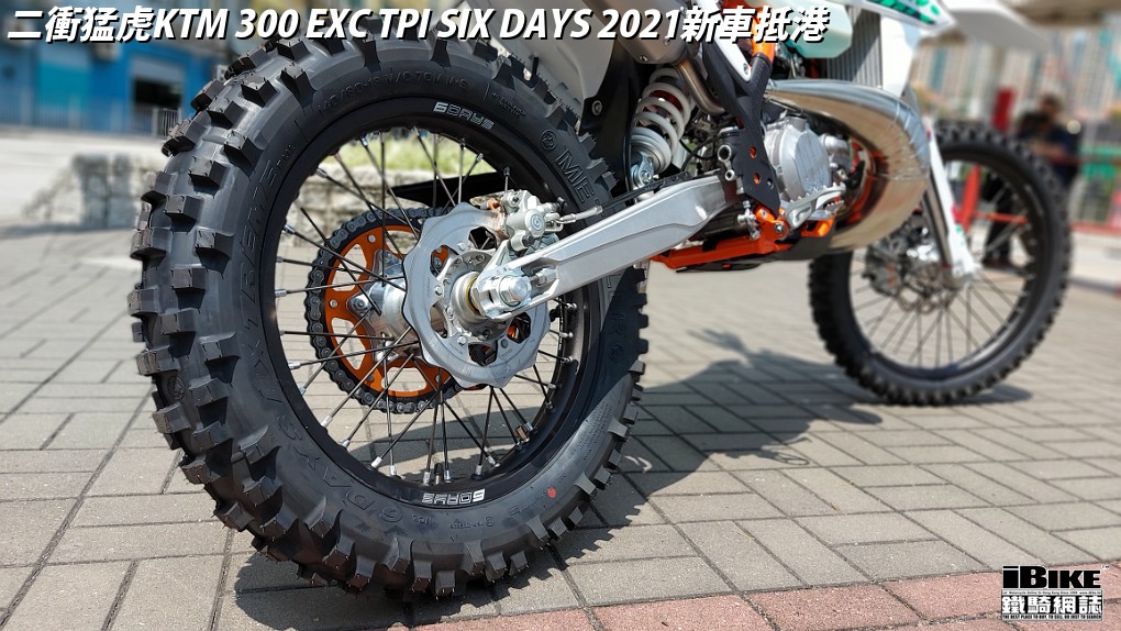

CNC machined hubs
High end rims made by Giant
New aluminium spoke nipples reworked for reduced frequency for tightening
MAXXIS EnduPro tyres
INSTRUMENTS, ELECTRICS
Electric start ignition
196W alternator and voltage regulator keeps the engine management well fed
EMS by Continental is mounted under the seat taking in several sensor’s data
Defines timing by intake air pressure, throttle, water temp and now an ambient air temp sensor
Lithium-Ion battery for the E-starter
CDI control unit improves the starting behaviour

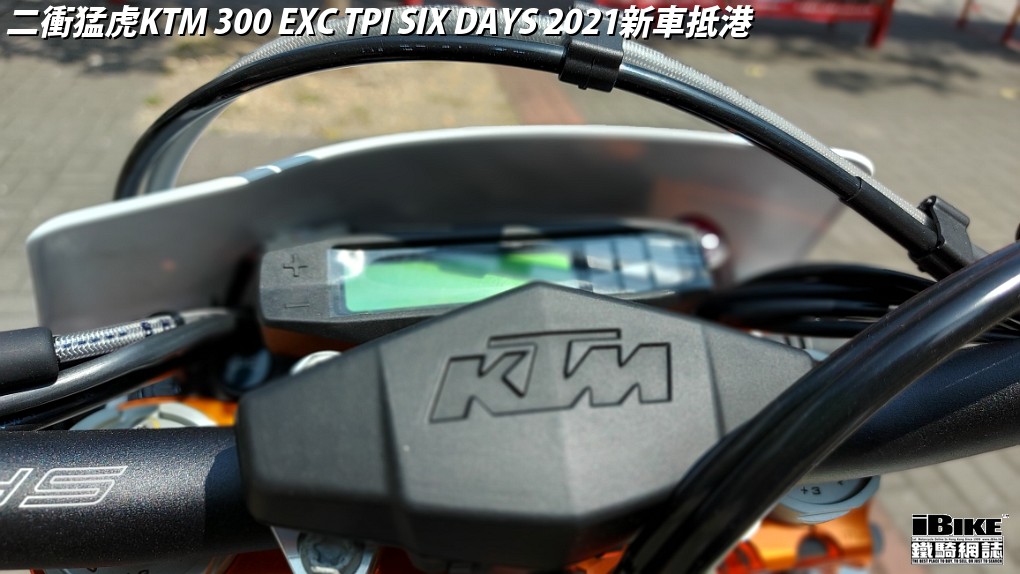

Battery operated backlit digital speedo, odometer, trip meter, hour m
