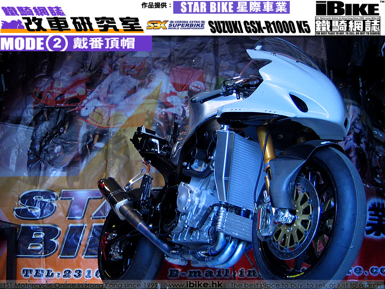

| BG-Performance  GSXR1000 K5 build spec Costing Sheet | Qty | UKPounds |  | US$ |  | HK$ |  | NT$ |
		| GRAND TOTAL :
		總價值 (英磅) |  | 47978 |  | 85617 |  | 663870 |  | 2879633 |

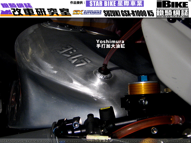

		| Yoshimura Aluminium 24L fuel tank 24L 耐力賽鋁制油缸 | 1 | 2144 |  | 3826 |  | 29666 |  | 128680 |
		| Yoshimura quick release tank pin set 油缸快拆扣 | 1 | 35 |  | 62 |  | 482 |  | 2091 |
		| Crescent quick release fuel cap 快速加油油缸盖 | 1 | 78 |  | 139 |  | 1079 |  | 4682 |

		| Tank foam 油缸海綿 | 1 | 35 |  | 62 |  | 484 |  | 2101 |

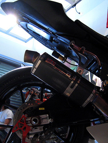

		| Yoshimura 4-1 Ti/carbon system with sump 全鈦賽車排氣 | 1 | 1771 |  | 3160 |  | 24501 |  | 106278 |

		| Parts Total: 配件總歇• |  | 34179 |  | 60992 |  | 472928 |  | 2051395 |
		| Standard Suzuki GSXR1000 K5 GSXR1000車一台 | 1 | 7489 |  | 13365 |  | 103630 |  | 449511 |
		| Labour to build GSXR1000K SBK from stock 65Hours | 改裝工資 | 4650 |  | 8298 |  | 64342 |  | 279093 |
		| Sundries/ lock wire/ oil/ hose clamps etc:
		什項 | 1 | 120 |  | 214 |  | 1660 |  | 7202 |
		| Job Total:
		全車總數 | 1 | 46438 |  | 82868 |  | 642561 |  | 2787202 |
