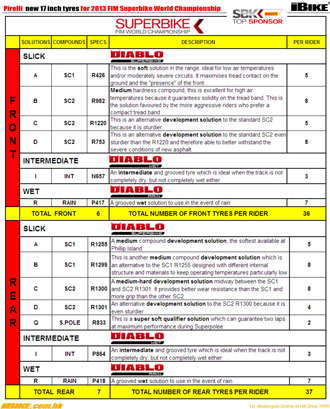

For the Superbike class, which has 21 riders on the starting grid (19 permanent and 2 wild cards), Pirelli will provide four slick solutions for dry on the front and as many for the rear. These are joined by the rear qualifier that riders will be able to use in the three Superpole sessions on Saturday and the intermediate and wet solutions available for both the front and the rear.
The slicks chosen by Pirelli on the front are an SC1 solution in a soft compound range and three SC2 solutions in medium compound, one of which is in the standard range and two more sturdy models which were custom designed to handle the new Australian asphalt.
For the rear Pirelli will provide the riders with a choice of four development solutions: two SC1 medium compound and two SC2 hard compound. Of the two SC2 solutions, one (the R1300) is a solution midway between the SC1 tyres and the SC2 R1301. It provides better wear resistance than the SC1 solutions and more grip than the other SC2. All of the rear solutions were developed using particular internal materials with the goal of keeping operating temperatures low in order to prevent overheating in the extreme areas of the left side tread.
In fact, overheating on the left side which can cause blistering is not a simple fix using a harder compound like one might think, but rather it is resolved by cooling the tyre from the inside with the use of specific structural materials. At the same time a blend which is too soft like the SC0 would wear too quickly on the new Australian asphalt which is particularly abrasive, and this is why it was not brought to this round.

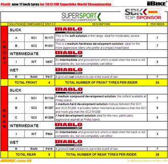

As for Supersport, which will have 35 riders lined up on the grid (33 permanent and 2 wild cards), the basic philosophy Pirelli adopted was the same as that used for the Superbike selections. The riders will be able to choose from two dry solutions, one in a soft SC1 compound and the other in a medium SC2 compound for the front and three solutions for the rear - one medium SC1 and two SC2 solutions in a harder blend, one of which (the R1287) is midway between the SC1 and the harder SC2 and it can guarantee better mechanical resistance than the SC1 and better grip than the sturdier SC2.
