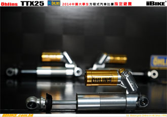

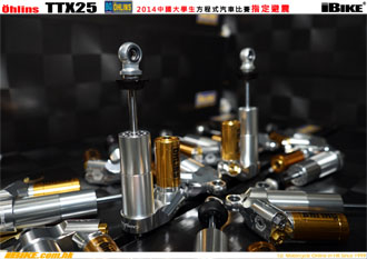

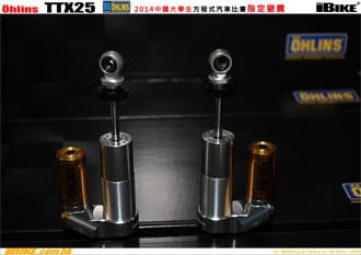

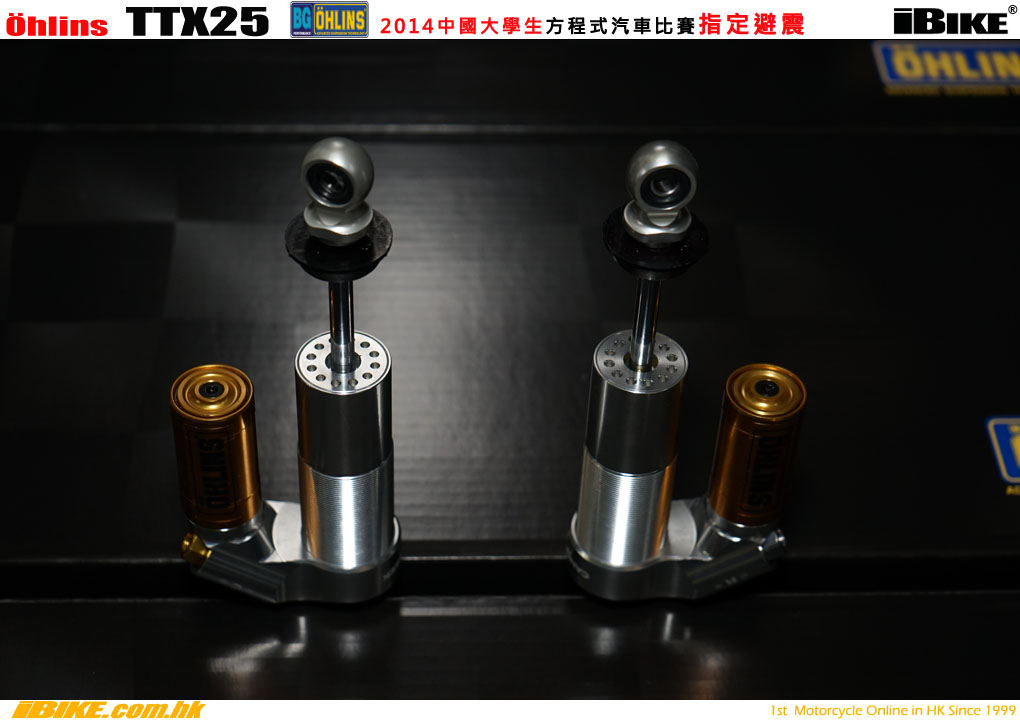

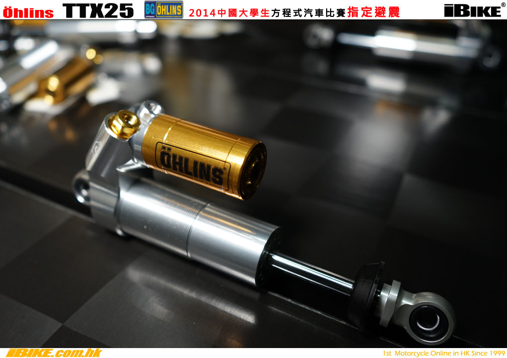

Öhlins
TTX25 is a
product centered in
the Formula SAE/Formula student collegiate
design organizations’ demands.

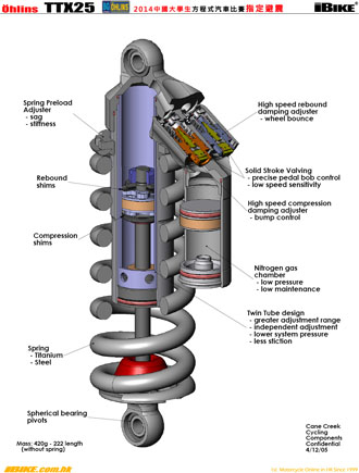

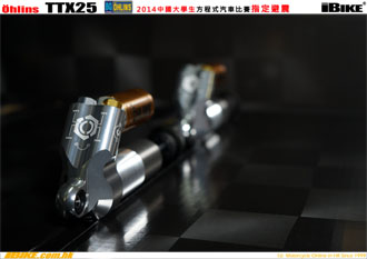

The TTX25 uses
modern twin tube technology, in a small package.

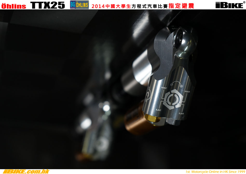

The 4-way externally adjustable damper is
completely serviceable by the end user, and
rebuild and revalve kits are available to make
the task easy. Also, available are spring kits,
spare parts, specialty tools, dynamometer plots,
CAD models, and other technical information.

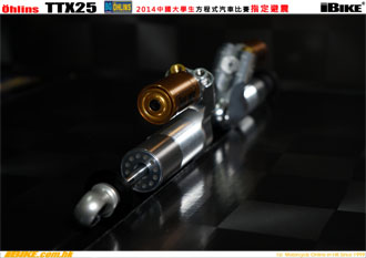

Specifications:
- Overall
length = 200 mm (center to center of
spherical bearings)
- Stroke = 57
mm
- Weight =
approx. 448 g (~1 lb) without spring
- Spherical
Bearing dimensions:
- ID = 8 mm
- Ball Width =
8 mm
- OD = 15 mm
Available Spring
Rates:
- 150 lb/in to
650 lb/in in 50lb/in increments
Rebuild Kit: Kit
includes all wear parts for one car set and 1
liter of Öhlins damper fluid.
Revalve Kit:1/2
Car Kit Includes:
- 4 - End
Adjusters (small bleed hole diameter)
- 4 -
Adjustment Needles (small bleed hole
diameter)
- 8 - High
Speed Valve Springs (4 -10 N/mm rate, 4 - 20
N/mm rate, 4 - 30 N/mm rate)
