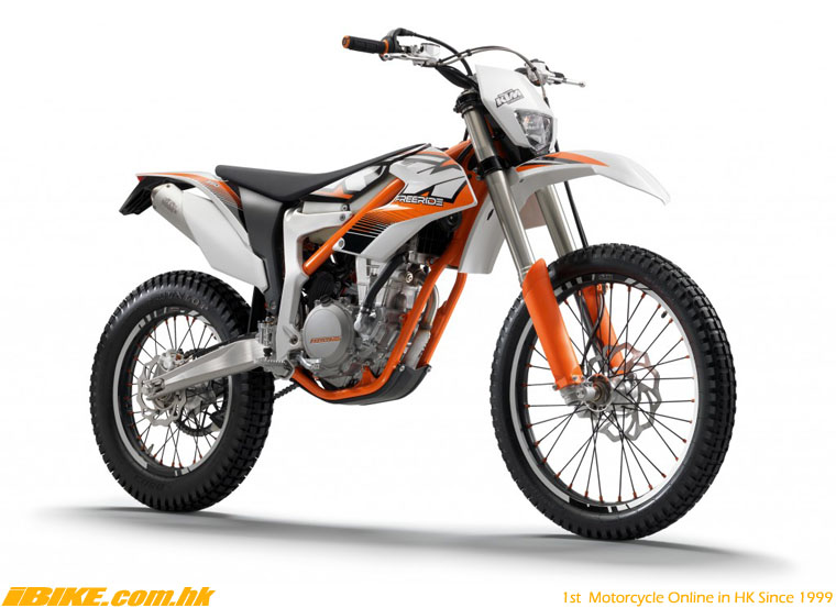

Design |
Single-cylinder, 4-stroke,
spark-ignition engine, liquid-cooled |
Displacement |
349.7 cm³ |
Bore |
88 mm |
Stroke |
57.5 mm |
Starting aid |
Electric starter |
Transmission |
6-speed, claw shifted |
Engine lubrication |
Forced oil lubrication with 2
Eaton pumps |
Primary gear ratio |
24:73 |
Secondary gear ratio |
11:48 |
Cooling system |
Liquid cooling system,
continuous circulation of cooling liquid with water pump |
Clutch |
Wet multi-disc clutch /
hydraulically operated |
Ignition system |
Contactless, controlled, fully
electronic ignition system with digital ignition timing
adjustment |
Frame |
Perimeter steel-aluminium
composite frame |
Fork |
WP Suspension4357
MXMA |
Shock absorber |
WP Suspension 4618
PDS DCC |
Suspension travel front |
250 mm |
Suspension travel rear |
260 mm |
Brake system front |
Formula disc brakes |
Brake system rear |
Brake discs - diameter front |
240 mm |
Brake discs - diameter rear |
210 mm |
Chain |
5/8 x 1/4” X‑Ring |
Steering head angle |
67° |
Wheelbase |
1,418±10 mm |
Ground clearance (unloaded) |
325 mm |
Seat height (unloaded) |
895 mm |
Total fuel tank capacity approx. |
5.5 l
Unleaded premium fuel (95 RON) |
Weight without fuel approx. |
99.5 kg |
